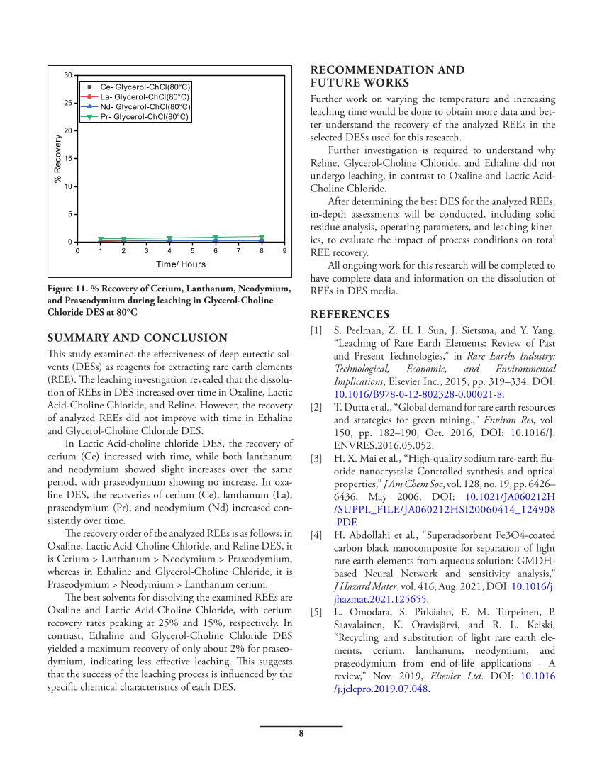

SUMMARY AND CONCLUSION
This study examined the effectiveness of deep eutectic sol-
vents (DESs) as reagents for extracting rare earth elements
(REE). The leaching investigation revealed that the dissolu-
tion of REEs in DES increased over time in Oxaline, Lactic
Acid-Choline Chloride, and Reline. However, the recovery
of analyzed REEs did not improve with time in Ethaline
and Glycerol-Choline Chloride DES.
In Lactic Acid-choline chloride DES, the recovery of
cerium (Ce) increased with time, while both lanthanum
and neodymium showed slight increases over the same
period, with praseodymium showing no increase. In oxa-
line DES, the recoveries of cerium (Ce), lanthanum (La),
praseodymium (Pr), and neodymium (Nd) increased con-
sistently over time.
The recovery order of the analyzed REEs is as follows: in
Oxaline, Lactic Acid-Choline Chloride, and Reline DES, it
is Cerium Lanthanum Neodymium Praseodymium,
whereas in Ethaline and Glycerol-Choline Chloride, it is
Praseodymium Neodymium Lanthanum cerium.
The best solvents for dissolving the examined REEs are
Oxaline and Lactic Acid-Choline Chloride, with cerium
recovery rates peaking at 25% and 15%, respectively. In
contrast, Ethaline and Glycerol-Choline Chloride DES
yielded a maximum recovery of only about 2% for praseo-
dymium, indicating less effective leaching. This suggests
that the success of the leaching process is influenced by the
specific chemical characteristics of each DES.

0 1 2 3 4 5 6 7 8 9
0
5
10
15
20
25
30
Time/ Hours
Ce- Glycerol-ChCl(80°C)
La- Glycerol-ChCl(80°C)
Nd- Glycerol-ChCl(80°C)
Pr- Glycerol-ChCl(80°C)
Figure 11. %Recovery of Cerium, Lanthanum, Neodymium,
and Praseodymium during leaching in Glycerol-Choline
Chloride DES at 80°C
Recovery
