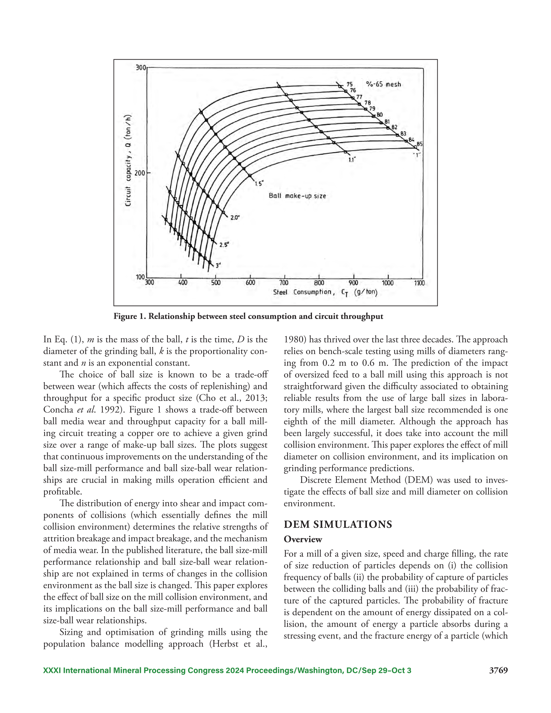

The choice of ball size is known to be a trade-off
between wear (which affects the costs of replenishing) and
throughput for a specific product size (Cho et al., 2013
Concha et al. 1992). Figure 1 shows a trade-off between
ball media wear and throughput capacity for a ball mill-
ing circuit treating a copper ore to achieve a given grind
size over a range of make-up ball sizes. The plots suggest
that continuous improvements on the understanding of the
ball size-mill performance and ball size-ball wear relation-
ships are crucial in making mills operation efficient and
profitable.

Figure 1. Relationship between steel consumption and circuit throughput
