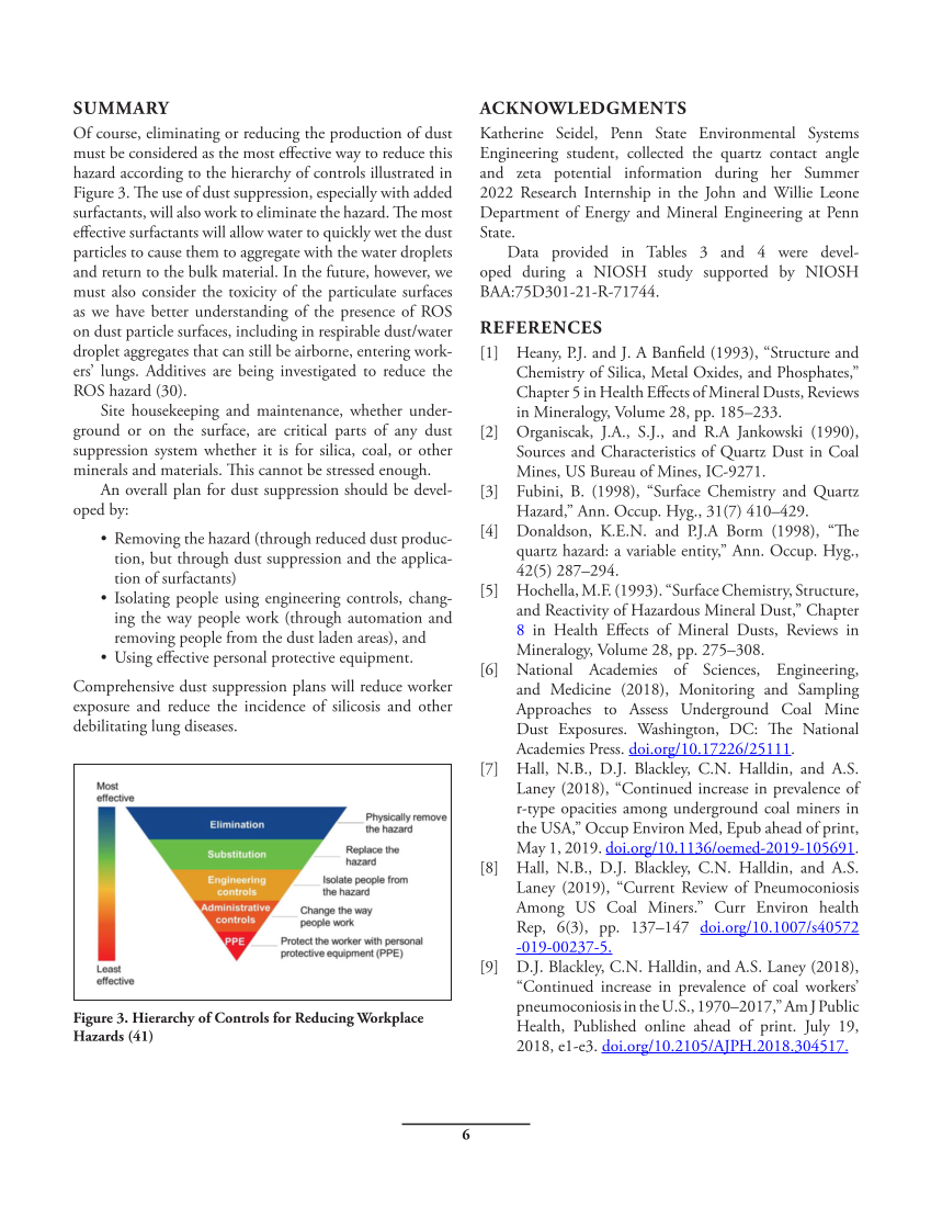

6
SUMMARY
Of course, eliminating or reducing the production of dust
must be considered as the most effective way to reduce this
hazard according to the hierarchy of controls illustrated in
Figure 3. The use of dust suppression, especially with added
surfactants, will also work to eliminate the hazard. The most
effective surfactants will allow water to quickly wet the dust
particles to cause them to aggregate with the water droplets
and return to the bulk material. In the future, however, we
must also consider the toxicity of the particulate surfaces
as we have better understanding of the presence of ROS
on dust particle surfaces, including in respirable dust/water
droplet aggregates that can still be airborne, entering work-
ers’ lungs. Additives are being investigated to reduce the
ROS hazard (30).
Site housekeeping and maintenance, whether under-
ground or on the surface, are critical parts of any dust
suppression system whether it is for silica, coal, or other
minerals and materials. This cannot be stressed enough.
An overall plan for dust suppression should be devel-
oped by:
• Removing the hazard (through reduced dust produc-
tion, but through dust suppression and the applica-
tion of surfactants)
• Isolating people using engineering controls, chang-
ing the way people work (through automation and
removing people from the dust laden areas), and
• Using effective personal protective equipment.
Comprehensive dust suppression plans will reduce worker
exposure and reduce the incidence of silicosis and other
debilitating lung diseases.

Figure 3. Hierarchy of Controls for Reducing Workplace
Hazards (41)
