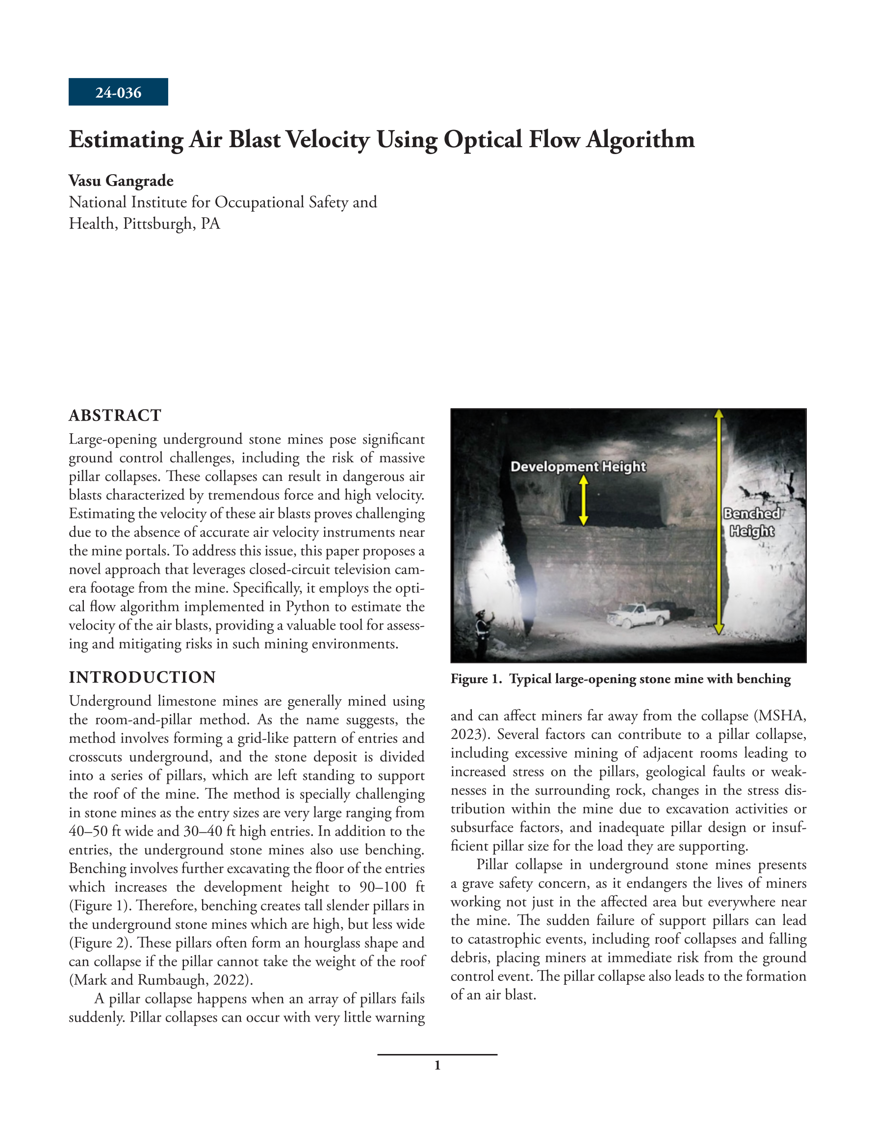

the roof of the mine. The method is specially challenging
in stone mines as the entry sizes are very large ranging from
40–50 ft wide and 30–40 ft high entries. In addition to the
entries, the underground stone mines also use benching.
Benching involves further excavating the floor of the entries
which increases the development height to 90–100 ft
(Figure 1). Therefore, benching creates tall slender pillars in
the underground stone mines which are high, but less wide
(Figure 2). These pillars often form an hourglass shape and
can collapse if the pillar cannot take the weight of the roof
(Mark and Rumbaugh, 2022).

Figure 1. Typical large-opening stone mine with benching
